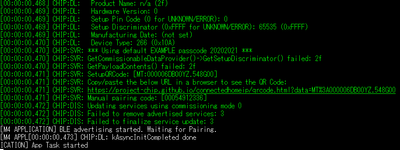

・Overview
This project involves the development of Matter devices. We encountered an issue with commissioning the device using the obtained vendor ID. Despite following the necessary steps, the commissioning process fails. Below, we detail the steps taken and request assistance in resolving the issue.
・Steps Taken
Registering the Device in the Test DCL
Registered the device for commissioning on the Test DCL.
Registered the vendor ID and device type.Modifying CHIPProjectConfig.h
Updated CHIP_DEVICE_CONFIG_DEVICE_VENDOR_ID and CHIP_DEVICE_CONFIG_DEVICE_PRODUCT_ID in CHIPProjectConfig.h to match the information registered in the Test DCL.Creating Matter Device Test Certificates
Followed the instructions to generate CD and DAC certificates.
Integrated the certificates into the header file.Build and Write
Built the modified project.
Wrote the build to the device.Commissioning
Attempted commissioning with a HomePod mini using an iPhone.
Here is the error log.
commissioning_error.log

2024-08-14 11:14 PM
Sorry, I was able to read the data written in genFactoryData.py and start Advertising and commissioning. it seems that the reason is that I did not write IterationCount, Spake2pSalt and salt.

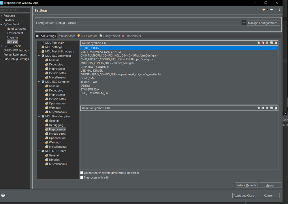

2024-08-01 12:35 AM
It seems the code does not handle correctly this situation, the signature is called with an example DAC, which is disabled by CONFIG_STM32_FACTORY_DATA_ENABLE being set to 1.
What you can do is modify the code like this to load the actual public key from flash:
#ifdef USE_STM32WBXX_DAC_CRYPTO
#if (CONFIG_STM32_FACTORY_DATA_ENABLE == 0)
otCksDAC_error = otCksDacSignature(messageToSign.data(), messageToSign.size(), DevelopmentCerts::kDacPublicKey.data(), &signature_bytes[0]);
memcpy(signature.Bytes(),&signature_bytes[0], Crypto::kP256_ECDSA_Signature_Length_Raw);
signature.SetLength(Crypto::kP256_ECDSA_Signature_Length_Raw);
if(otCksDAC_error != OT_ERROR_NONE) {
ChipLogProgress(Crypto, "DAC signature unexpected failure");
return CHIP_ERROR_INTERNAL;
#else
uint8_t Publickeybuffer[PUBLIC_KEY_LEN];
uint32_t tlvDataLength; // Dummy value keys values are fix
FACTORYDATA_StatusTypeDef err;
err = FACTORYDATA_GetValue(TAG_ID_DEVICE_ATTESTATION_PUBLIC_KEY, Publickeybuffer, PUBLIC_KEY_LEN, &tlvDataLength);
VerifyOrReturnError(DATAFACTORY_OK == err, MapSTM32WBError(err));
ByteSpan Publickey = ByteSpan(Publickeybuffer);
otCksDAC_error = otCksDacSignature(messageToSign.data(), messageToSign.size(), Publickey.data(), &signature_bytes[0]);
#endif
And the USE_STM32WBXX_DAC_CRYPTO flag needs to be set inside project settings to properly propagate everywhere, like this (for both GCC compiler and G++ compiler options):
This way, it compiles ok on my side, I haven't actually tested the whole functionality.

Also, I have changed some parts of the FactoryDataProvider.cpp as you provided previously, but it seems that Serial Number, Product Name, Setup Pin Code, etc. cannot be read and Advertising is not started.
Can you please help me to find the cause of this problem?
2024-08-14 11:14 PM
