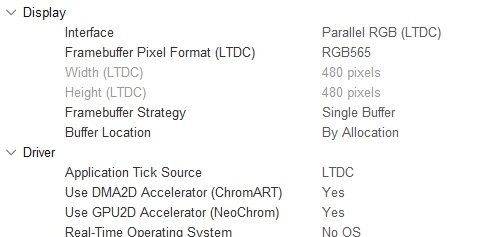

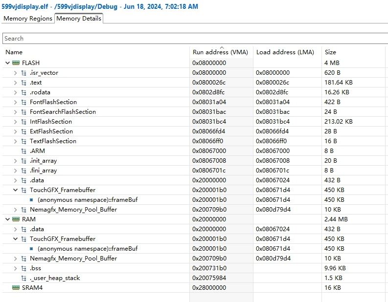

I made a touchgfx project by CubeIDE,when I choose touchgfx framebuffer by allocation,after build ,the framebuffer is placed into flash,then ram.I wonder why.
Hi @amb ,
It seems to be located at RAM 0x2001b0 right ? I guess the issue is that it is initialized by C++ RTE. The frame buffers needs to be marked by some gcc speciofic __attribute__, hm is it 'noinit' ?

The framebuffer needs to be in the RAM (either internal or external). But how you did conclude that the frame buffer is located in the Flash? Which board are you using? ST or custom board? which MCU?
Need to provide more details, so TouchGFX expert(s) could help you.
this is the memory details form CubeIDE.
this is touchgfx settings

I found the framebuf[] in TouchGFXGeneratedHAL.cpp file.It says this:
// Use the section "TouchGFX_Framebuffer" in the linker script to specify the placement of the buffer
LOCATION_PRAGMA_NOLOAD("TouchGFX_Framebuffer")
uint32_t frameBuf[(480 * 480 * 2 + 3) / 4] LOCATION_ATTRIBUTE_NOLOAD("TouchGFX_Framebuffer");
static uint16_t lcd_int_active_line;
static uint16_t lcd_int_porch_line;
this file is auto generated,I didnt change it.

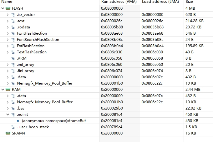

hello @ferro
I tried change like this:
uint32_t frameBuf[(480 * 480 * 2 + 3) / 4] __attribute__ ((section (".noinit")));
this frameBuf array is indeed only in ram now.and the program still works fine.

Hi @amb
>"frameBuf array is indeed only in ram now"
Splendid. But still, it is strange that the frameBuf with all the ornamentation
 was initialised. Could you please try again the old version and see if the flashing of the FW is noticably longer compared to correct version ? To flash 0.5 MB (framebuffer initialisation) seems like a lot. Maybe other people waste lot of FLASH and time waiting to flash this as well. Might require Gfx fix; maybe add some warning or even throw a compiler error.
hello @ferro
The answer is affirmtive. this is log output using (noinit):
Memory Programming ...
Opening and parsing file: ST-LINK_GDB_server_a18780.srec
File : ST-LINK_GDB_server_a18780.srec
Address : 0x08000000
Erasing internal memory sectors [0 55]
Download in Progress:
File download complete
Time elapsed during download operation: 00:00:05.514
and this is log output using(LOCATION_PRAGMA_NOLOAD:(
Opening and parsing file: ST-LINK_GDB_server_a19312.srec
File : ST-LINK_GDB_server_a19312.srec
Erasing internal memory sectors [0 111]
Time elapsed during download operation: 00:00:10.102
So,the flash occupied 55 sectors VS 111 sectors,and the flashing time is 5.5s VS 10.1s,
significantly longer.
download size have 450kb difference, that is exactly my framebuffer size:480*480*2.
