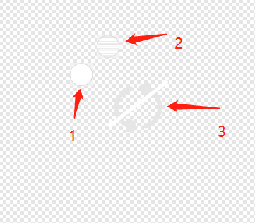

I did a finger drag image experiment.
When the picture is in L8 format , the setupDataCopy() will be never called . So is it completely done by the CPU?@Martin KJELDSEN
This is my interface:
1: L8_RGB888
2: L8_RGB565
3: ARGB8888
When I drag image1 or image2 by finger , the setupDataCopy() will not be called.
When I drag image3 the setupDataCopy() will be called.
If you don't have the ChromartDMA class i shared in this community, then yes it's drawn by CPU. Working on adding support to the Generator so that it can generate L8 support for all MCUs in the TouchGFX DMA class.
