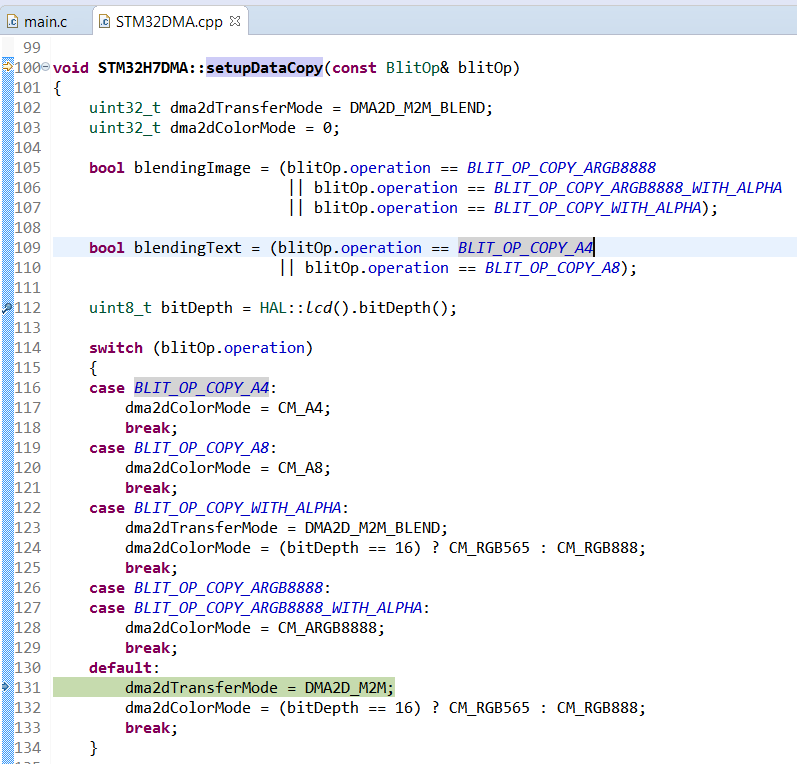

2020-05-20 6:00 AM
My guess is that your ChromART/DMA2D class doesn't support L8. Break inside setupDataCopy() to figure out if it's getting called for the image being moved.
2020-05-20 6:24 AM

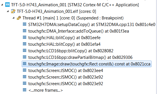

It appears that it is.....
Debug callstack,
2020-05-20 6:57 AM

As I stated in the post description. When the image is formatted as an L8, the animation onto the screen is very choppy.
I don't see where the CLUT is even referenced in STM32H7DMA, so i am wondering if it does support L8.
Is there anyway you can test this out yourself?
2020-05-20 12:48 PM
I am using my own custom board. I don't have an STM32H743I-Eval, but I just created a project based on that Template and compared the stm32h7xx_hal_dma2d.c between my project and the one created by the Application Template and they are identical.
As I stated, I do not have an STM32H743I-Eval, so I cannot test it's performance.
