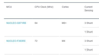

Good day,

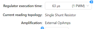

I'm trying to get motor profiler running on an X-Nucleo-IHM17M1. The only compatible Nucleo board I have is a F303RE.
To enable the motor profiler application, it requires the selection of 3 shunt current sensing. According to this link, it seems that both the IHM17M1 and F303RE support 3 shunt current sensing.
Yet, when I try and configure the project, only single shunt is available. This is not the case for the other Nucleo boards.

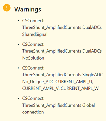

That said, I do receive the following warning when creating the project.
Is there any solution for this, or should I use a different Nulceo board?
Gael A
Hello JandreFrey,
The reason why the NUCLEO-F303 coupled with the IHM17 does not support Three Shunt operation is because of the available ADCs. There are two flavours of Three Shunt theoretically available in your case : one using 1 ADC, one using 2 ADCs.
Let's first have a look at the available pins for each Current Phase :
Phase U : ML34 -> PB0 -> ADC3_IN12
Phase V : MR24 -> PB1 -> ADC3_IN1
Phase W : MR16 -> PB12 -> ADC4_IN3
                  MR26 -> PB15 -> ADC4_IN5
                  MR15 -> PA7 -> ADC2_IN4
For the 1-ADC topology, the three current sensing pins must have the same ADC, which is not the case here : PB0 and PB1 only have ADC3, whereas the three available pins for Phase W do not offer any ADC3 channel
For the 2-ADC topology, we require one of the phase to give access to 2 different ADCs, which is not the case for any of the available pins.
This is why, despite the fact that the F303RE and the IHM17 both support 3-Shunt driving on their own, it cannot be done using these two boards together. Therefore, you should use a different Nucleo board.

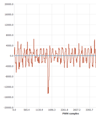

Hi Gael,
Apologies, next time I will create a new thread. For now, since I have posted here, I will reply to your post.
I have tried tuning the gains according to your suggestions, with no success. I can only barely get the motor spinning. Most times it simply does not spin up.
I have increased the PWM freq to 48 kHz. The motor now goes up to 7000RPM which is still VERY low. It also gets quite hot, so I think something is still very wrong.
Here are the graphs from when the setpoint is set above 7kRPM:
And below 7kRPM:

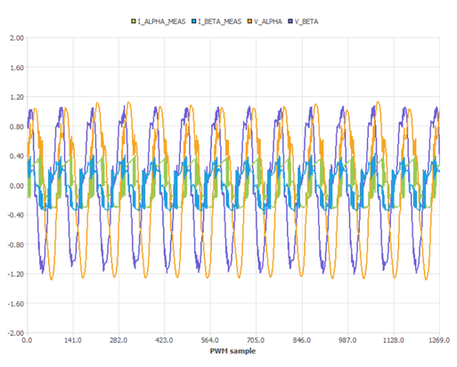

I'm yet to get a new Nucleo to perform characterisation.
Something worth noting is that the motor friction and inertia is too small for the entry box in the wizard. they default to 0.001. This might throw off the speed gain calculation.
Regards,
Jandre

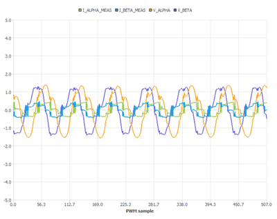

EDIT: I was able to increase the motor RPM considerably by supplying the full 6V and increasing allowed current.
The motor does now spin up to 10-12kRPM. It is rated up to 50kRPM, but I guess there's going to be a limit with the PWM and controller bandwidth. Here are the logs at 10kRPM.

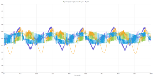

However, I do still struggle to get it started. Should a ramp-up be implemented, or is the controller supposed to automatically ramp up the motor?
As for sensorless control, I do get a startup failure (FAULT_OVER) error when closed-loop takes over from sensorless, which I suspect has to do with the back-EMF sensing. Plotted below is what the back-emf observer outputs when the motor is ramped in open loop to 4kRPM and held there for 5 seconds.
The 6-STEP simply does not turn on the outputs, and shows no errors.
Gael A
Hello JandreFrey,
I am glad you found a way to increase the reached speed. As you said, it indeed falls under your responsibility to tune your current ramp up to achieve a good switch over from open loop to close loop control. A conservative way to approach the problem is to set a high current level with law speed ramp (ensure the motor stays hooked up), until relatively high speed (the higher the B-EMF, the easier it is to estimate the speed).
