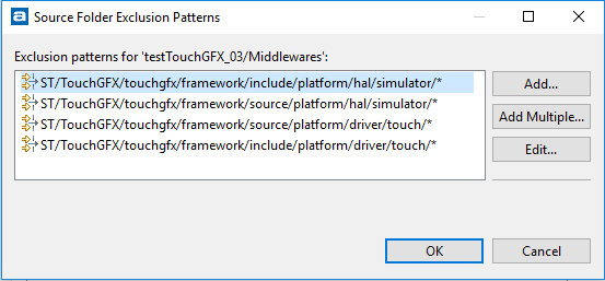

2019-03-11 2:47 AM
Hi Anderson...
I've try excluding the paths as in your previous post but this doesn't seems to work for me... as I'm getting an error regarding shellapi.h
Description Resource Path Location Type
fatal error: shellapi.h: No such file or directory main.cpp /testTouchGFX_03/TouchGFX/simulator line 30 C/C++ Problem
below is my latest exclusion pattern (I've tested different combinations)...
I'm using Atollic 9.3.0 and CubeMX5.1.0 on a STM32F746G-Disco.
Can you share more info on your setup ?
Best Regards,
Giampaolo
PS: RTTI has been already exluded as mentioned elsewere...
2019-03-14 12:36 PM
Hi @iw2lsi ,
I think you need to exclude from build the folder project/TouchGFX/simulator
And for me I didn't exclude the include/plataform/driver/touch
Try it.
Regards,
Anderson
