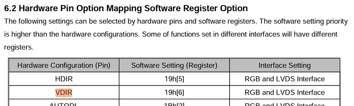

I work with many displays , and all have hw control for orientation, then your explain isnt real.
Okay great, I'd like to understand - can you explain how I can mirror a screen in hardware on a STM32H7xx device?
Display connected by RGB565 Interface, LTDC, DMA2D, double buffering, TGFX.
Thanks.
You require Driver IC info and controller bus connection to display registers setup. Some displays have two pin on connector , that by sel high or low level rotate etc. You as designer have job to choice right display.

Show your display info and dont waste time with this theory. RGB dont define, that display skips internal memory, and some displays dont have internal memory and accept setups for rotation...
One example ST7262 800x480
