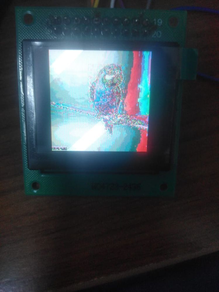

I have already integrated Touch GFX and the driver I am using takes input in the form of uint8_t. The driver function for drawing a bitmap is:
HAL SPI Transmit(&hspi3, (uint8_t*) image, 40960, 10);
However, the Touch GFX frame buffer is in constant uint16_t* format, accessed via the get client frame Buffer(); function. To match the driver input, I typecast the framebuffer to constant uint8_t*:
(constant uint8_t*) get client frame buffer();
Despite this, the image displayed on the OLED screen appears distorted. I suspect the issue lies in the way the 16-bit frame buffer is being handled by the driver, as it expects 8-bit data.
Can you please help me understand the cause of this distortion and suggest the best approach to resolve it?
Typecasting a pointer won't change the data.
You probably need to change byte order.
You do this by modifying the original buffer or by creating a separate buffer with the converted values.
Some L4 models contain hardware acceleration (chromart) that can potentially help with this. But since you refused to answer my question I don't know what model you have.
Please upload a photo of this.

Looks like color bits are mixed up. What's the original image? Perhaps you can try a different test image such as a rainbow.

Tried rainbow image same issue

Can you compare the bytes being send by the driver compared to what is being send now?
Then we know what needs to be changed.
DMA2D can do byte swapping.
"Kudo posts if you have the same problem and kudo replies if the solution works.Click ""Accept as Solution"" if a reply solved your problem. If no solution was posted please answer with your own."

Spi data transfer is of 8 bits, if i pass 16 bit value, the image is getting mess up, touch frame buffer is also return 16 bit array ,.. Because i set color depth to RGB 565,
If get touch gfx buffer in terms of uint8_t i think my problem will get sorted
The MCU is little endian. So typecasted as uint8 array will be LSB first.
No. That wouldn't matter. The color bits are in a different format.
You can also change the display buffer in the debugger. All 1's is white, all 0's is black. You can quickly see the format of the color bits.
