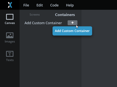

Then, on your application, just go to the "Containers" tab and click on the "+" icon :
Then, you can add shapes, images, etc that you will need for your custom widget.

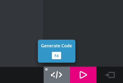

Then, click on "Generate code":

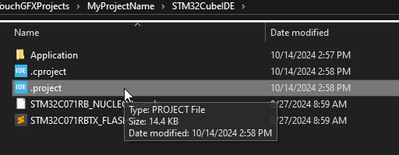

Then you can open the folder where your project is inside your favorite text editor or IDE (in that case, STM32CubeIDE):
The custom container code will be under TouchGFX => gui => source => container.
From there you can code custom behavior.
