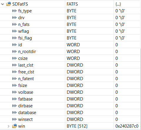

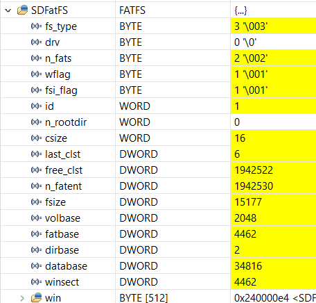

Thanks for the tip. I gave it a try, even around the  MX_SDMMC1_SD_Init();
 MX_FATFS_Init() commands. Had no effect unfortunately. This is what I obtain through debug (all zero's (top)) and what I expect is at the bottom...
