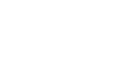

The new version of TouchGFX (V4.21.0, V4.21.1) displays the text of a Button With Label no more vertical centered. In the designer the text is shown correctly, but in the simulator and in the compiled controller application it is positioned too high.
Is there a way to correct the position?

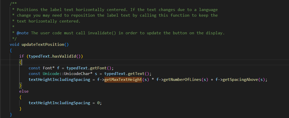

We modified the way we position the text inside the Button with Label between v.4.20.0 and v.4.21.0.
We did those changes to reposition the label text if the font includes a character that goes lower that the font baseline, for example "g".
If you want to get the same behavior as before, you can modify the updateTextPosition() inside the touchgfx\framework\include\touchgfx\widgets\ButtonWithLabel.hpp file inside your project.
You can modify text height spacing by replacing getHeight() by getMaxTextHeight(), like this :

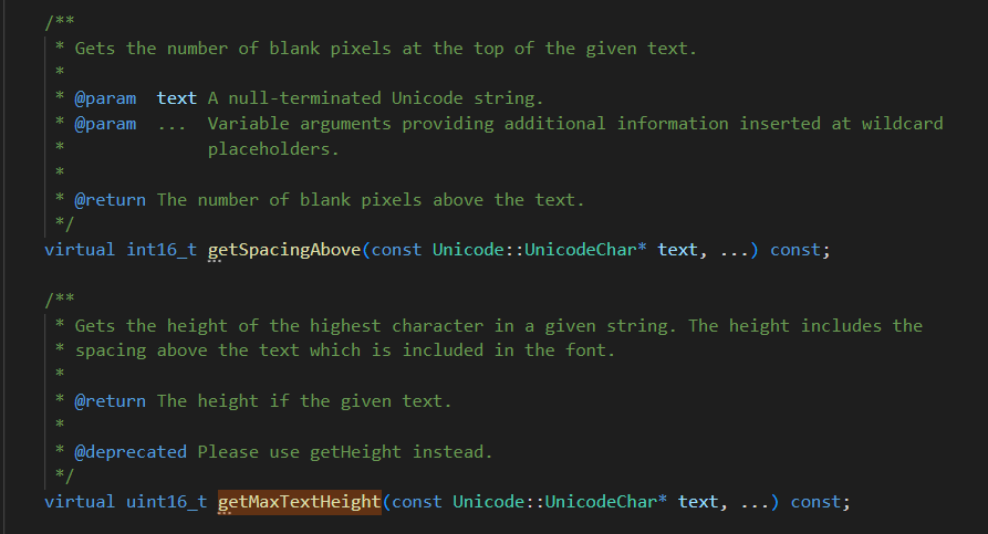

0693W00000aJeBaQAK.pngAlso, since getMaxTextHeight() is now a deprecated method, you'll also have to remove the deprecation tag inside the touchgfx\framework\include\touchgfx\Font.hpp file :

Hello Yoann,
thank you for your help. I have made your suggested modifications and it works with the same behavior as before (that I prefer in this application).
