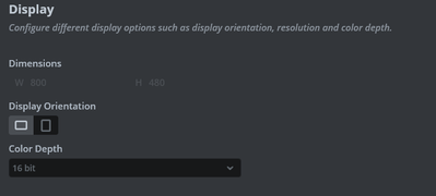

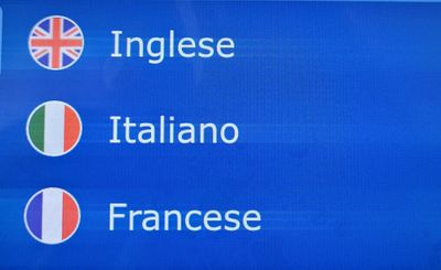

I'm experiencing a strange horizontal ghost/stripe effect mostly on light images (it's very visibile in text)
What could it be?
I'm using the STM32H7S78 microcontroller

GaetanGodart
Hello @nico23 ,
It looks like the issue doesn't only happen on text but also on the left of the flags.
Are you using a custom board or are you using the STM32H7S78-DK?
Regards,
Gaetan Godart
Software engineer at ST (TouchGFX)
Yes, it seems the issue happens on white/very bright pixels mostly

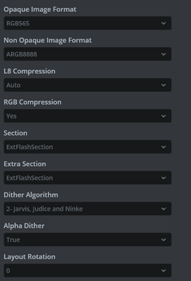

I'm using I-Cache with SCB_EnableICache and
static void MX_DMA2D_Init(void)
  /* USER CODE BEGIN DMA2D_Init 0 */
  hdma2d.Instance = DMA2D;
  hdma2d.Init.Mode = DMA2D_R2M;
  hdma2d.Init.ColorMode = DMA2D_OUTPUT_RGB888;
  hdma2d.Init.OutputOffset = 0;
  /* USER CODE END DMA2D_Init 0 */
  if (HAL_DMA2D_Init(&hdma2d) != HAL_OK)
    Error_Handler();
  /* USER CODE BEGIN DMA2D_Init 2 */
  /* USER CODE END DMA2D_Init 2 */
and GPU2D
static void MX_GPU2D_Init(void)
  /* USER CODE BEGIN GPU2D_Init 0 */
  /* USER CODE END GPU2D_Init 0 */
  /* USER CODE BEGIN GPU2D_Init 1 */
  /* USER CODE END GPU2D_Init 1 */
  hgpu2d.Instance = GPU2D;
  if (HAL_GPU2D_Init(&hgpu2d) != HAL_OK)
    Error_Handler();
  /* USER CODE BEGIN GPU2D_Init 2 */
  /* USER CODE END GPU2D_Init 2 */
is there a specific thing I should look into to see what's wrong with the rendering?

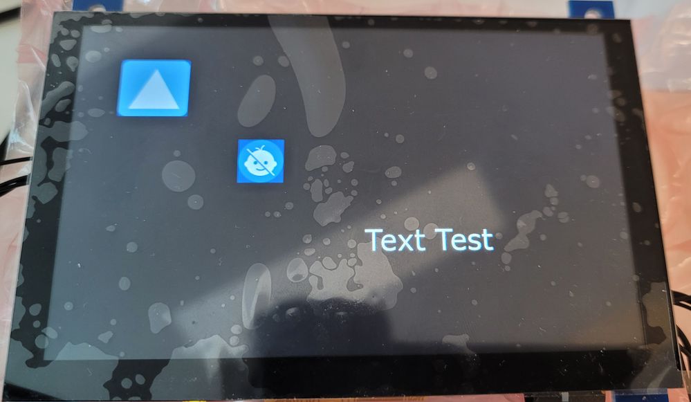

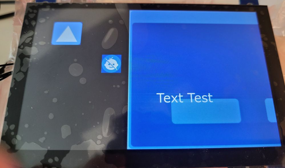

nico23
Senior III
Hi @Ozone
I've done other tries.
It turnes out the issue appears when I use a full background image. When there's no background image, no issue is detected. Please see below
Hello @nico23 ,
Did you add an image or a box?
Can you try to add a box as a background? Try different colors.
What part of the display do you invalidate?
Regards,
nico23
Senior III
Hi @GGODA
the background is an image.
In the latest two images, I've just generated the code. No user code is added.
I'll try with a box as background
