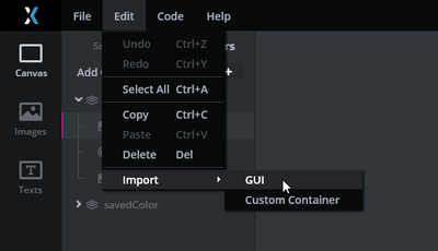

To migrate a GUI, click on Edit => Import => GUI
Then, in the file navigator, select the .touchgfx file of your previous project (the one on STM32F407ZET6).
This process will import the GUI and the assets (images, etc) and the code in the projectName/GUI/include and projectName/GUI/src folders (that is the code that you wrote yourself previously to make your project work.
Can you try that and tell me how it goes?

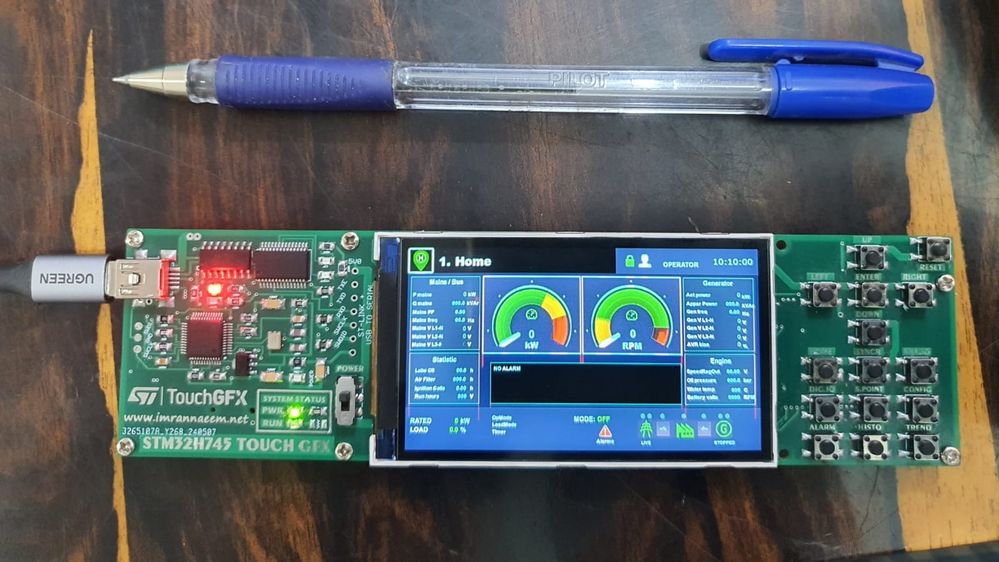

 Hi alexeyskosnyagin .
I have been playing with multiple screens with out any problem.
check my reply in following old post , in which I tried to explain keys handling .
https://community.st.com/t5/stm32-mcus-touchgfx-and-gui/toughgfx-change-screen-from-button-virtual-function/m-p/580148#M34229
As per my understanding , you have done some part correctly , but transitions between screens need interrupted base hardware keys .
here is my latest TouchGFX Board with STM32H745 & 2.95" , 854X480 TFT.
The board has hardware keys with MCP23S17 SPI IO Expander with Interrupt.
I have 9 different screens till now in this tiny TouchGFX experiment.
I will look in your codes and will revert back.
