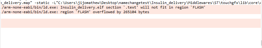

hello,
I'm currently developing an application that features more than 150 screens. However, I've encountered a significant challenge: once I build the code, the overall size exceeds the available flash memory. While I'm using external flash for images, I still need a solution to accommodate the large code base . What strategies or best practices can I implement to optimize my application’s size and ensure it runs smoothly? Any insights or recommendations would be greatly appreciated!
Check you linker file and map file and find what you could move from the internal flash to the external one.
How much Flash do you have?
What is the size of your built app?
1024 KB (STM 32 L496ZG) Microcontroller, once i build it is taking more than 100 percentage of flash
Including TouchGFX stuff?
yes,
So what is the purpose of the external Flash memory if you are locating TouchGFX stuff into the internal memory?
 To load Images
and what about the external Flash?
Please try to give as much information as possible, rather than just drip-feeding it.
https://community.st.com/t5/community-guidelines/how-to-write-your-question-to-maximize-your-chances-to-find-a/ta-p/575228
My application is built with an STM 32 L496ZG microcontroller, OLED display, and touch GFX, using touch GFX I have designed about 150 screens that have text boxes and images. External Flash(16MB)  is interfaced with a microcontroller to store the images used on different screens once, I try to build this code I get the following error.overflowerror.png
