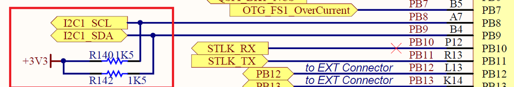

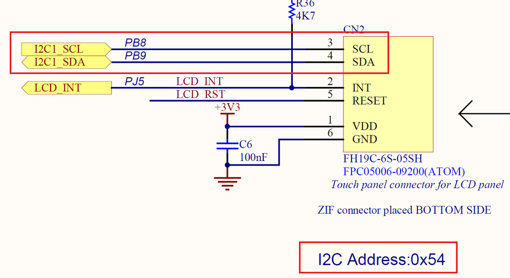

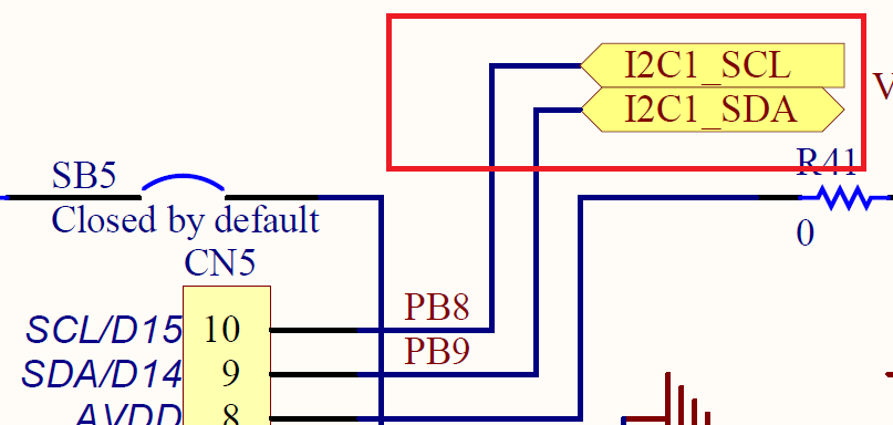

Be careful, if you are using I2C1 (PB8/PB9) for your sensors, LCD touch panel is using the same bus.. Refer to the schematics from this link.
So you need to manage I2C bus addresses .. LCD touch panel I2C address is 0x54 and pull-up resistors are already available on the board.
Arduino connector:

Hi SofLit,
Thanks i am Aware that I2C1 is located on the PB8 and PB9 but my problem is when Touch GFX hold the line busy always without allowing the bus for other sensors hence not able to initialize the sensors or able to work with it.( i.e My STM32f469I discovery has only one I2C bus avaiable for both touch and other sensors)
Hope you understand what i mean.
