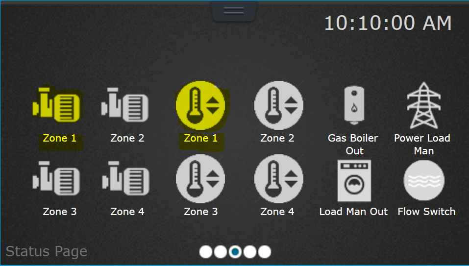

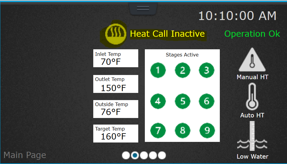

‎2021-06-01 5:25 AM
Hi Alexandre,
See the following images. I have external interrupts which cause each of the zones to illuminate with respect to which interrupt was activated. Both of the screenshots are part of the same screen, just within a swipe container. For each interrupt the respective zones (1-4) properly illuminate in the first image. What is also supposed to happen in the second image on any of the interrupts driven is that the 'global' heat call active/inactive is supposed to illuminate as well.
What I can't figure out is why it only does it for zone 4 in the following code. I've debugged and each of the setZone4HeatCallStatus(uint8_t status) breakpoints are reached (as also evidenced by the state changes of the toggle buttons/images in the first image.

‎2021-06-01 8:24 AM
Hi Romain,
That is exactly what is happening, I have the updates for all four zones coming together and updated together so the global status was always reset by another zone call. Only when zone4 is active is the status not getting reset to 0 as it's the last to update.
I just needed to added a state variable for each zone and update accordingly.
Thanks!
