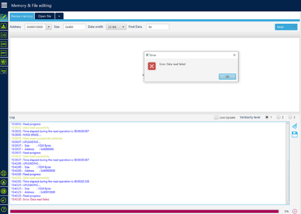

The custom made external loader, failed to make multiple Reads, (STM32CubeProgrammer returns error)
‎2023-05-04 7:54 AM - edited ‎2023-11-20 6:27 AM

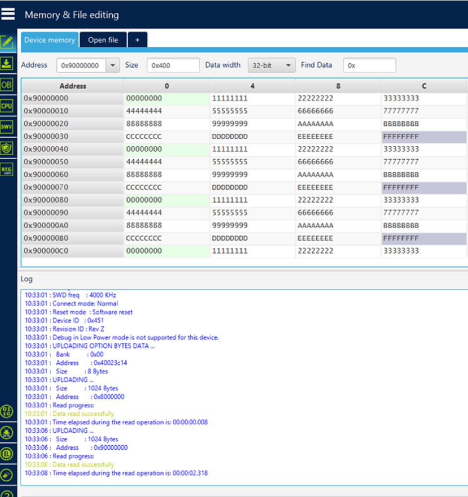

I follow the guide to make an external loader and it works for the most part. I can erase sectors, write data. But I can only read data once. If I try make multiple Read, STM32CubeProgrammer returns error. See example below:
Example:
14:56:32 : Time elapsed during the read operation is: 00:00:00.007
14:56:35 : UPLOADING ...
14:56:35 : Size : 1024 Bytes
14:56:35 : Address : 0x90000000
14:56:35 : Read progress:
14:56:37 : Data read successfully
14:56:37 : Time elapsed during the read operation is: 00:00:02.314
15:18:18 : UPLOADING ...
15:18:18 : Size : 1024 Bytes
15:18:18 : Address : 0x90010000
15:18:18 : Read progress:
15:18:26 : Error: Data read failed
It does not matter, which start address I use in the second read request. If I use Address: 0x90000000, in the second read I receive same error.

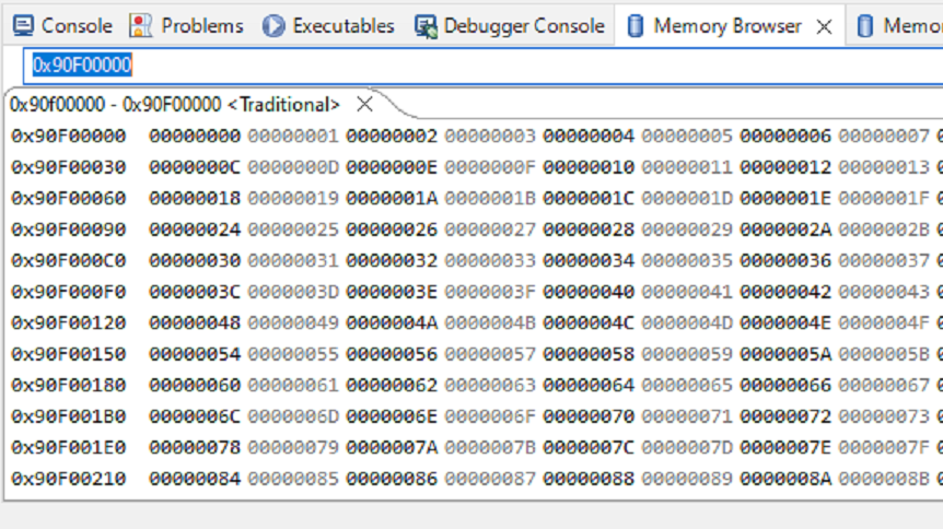

I have tested the code in "non-extern-loader-mode", by change the linker file from linker.ld to STM32F767IITX_FLASH.ld.

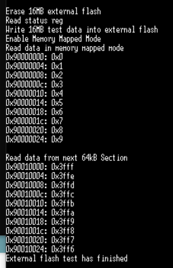

The code in the main() is then executed. I am then able to enable memory mapped mode and make several read from different segments in the external flash.
Example:
Erase 16MB external flash
Write 16MB test data into external flash
Enable Memory Mapped Mode
Read data in memory mapped mode
0x90000000: 0x0
0x90000004: 0x1
0x90000008: 0x2
0x9000000c: 0x3
Read data from next 64kB Section
0x90010000: 0x3fff
0x90010004: 0x3ffe
0x90010008: 0x3ffd
0x9001000c: 0x3ffc

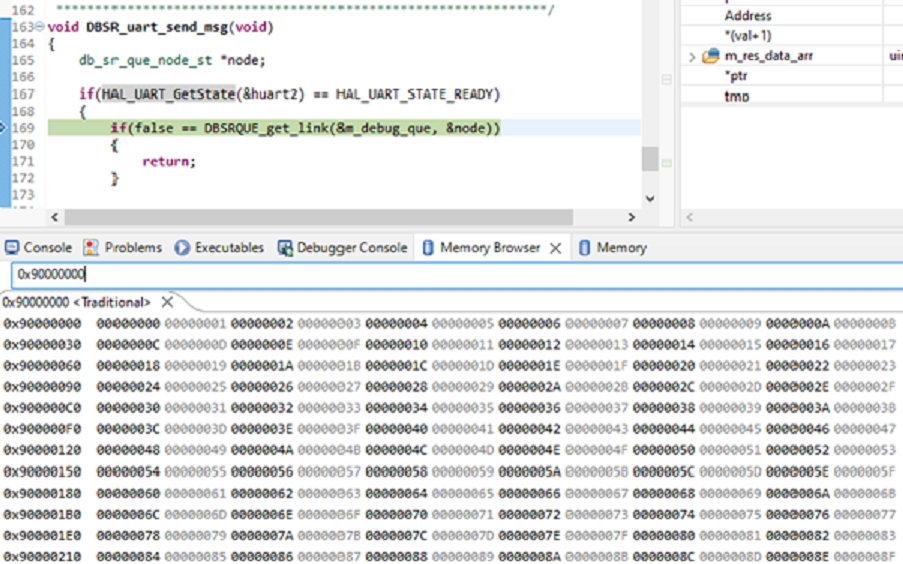

When I execute code in "non-extern-loader-mode"
I am then able to use ST-Link and STM32CubeIde memory browser and view several memory sectors without any problem, so the driver seems to work as it should.
The file: Loader_Src.c
In the end of the function Init(), I invoke BSP_QSPI_EnableMemoryMappedMode(). This function is also invoked in the beginning of the function Verify().
What could be the problem in "external loader mode"? Read operation is managed directly by CubeProgrammer. Any Idea?

‎2023-05-08 1:11 AM
I have noticed that if I do a disconnect and then connect, it is possible to read from extrnal flash memory one more time, without any problem. As long as I disconnect and then connect I can read over and over again.
In the Log panel, I have also increased the verbosity level to 3 so more information is shown. See below:
First read works fine (Does not matter how many lines i read, always work)

Second read always failed
19:53:52:771 : UPLOADING ...
19:53:52:771 : Size : 1024 Bytes
19:53:52:771 : Address : 0x90010000
19:53:52:771 : Read progress:
19:53:52:771 : Reading data...

19:54:00:001 : halt ap 0
19:54:00:001 : Init function fail with timeout
19:54:00:007 : r ap 0 reg 16 xPSR 0x21000036
19:54:00:177 : halt ap 0
19:54:00:177 : w ap 0 reg 15 PC (0x20000000)
19:54:00:183 : w ap 0 reg 17 MSP (0x20000500)
19:54:00:185 : w ap 0 reg 16 xPSR (0x01000000)
19:54:00:289 : Error: Data read failed
