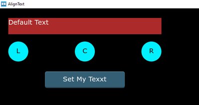

In touchgfx designer(Version:4.21.3) I have set to Left alignment. I use this textarea for multiple purposes, for few I need to set to Left alignment and for few I need to set to Right alignment. I tried using ' textArea.setTextAlignment(TEXT_ALIGNMENT_RIGHT);'  but it says set alignment is not a member.
Hi @BhavyaSri
I use TextAreaWithOneWildcard
// T_ALIGN_LEFT, T_ALIGN_CENTER, T_ALIGN_RIGHT Ids text is "<>" with different alignment
// T_TEXT_MULTIALIGN holds the text to dispaly and alignment does not matter
TextAreaWithOneWildcard::setTypedText ( touchgfx::TypedText ( T_ALIGN_CENTER    )            );
TextAreaWithOneWildcard::setWildcard  ( touchgfx::TypedText ( T_TEXT_MULTIALIGN ).getText () );
TextAreaWithOneWildcard::invalidate   ();

I cannot use from designer as I use Same textarea for multiple applications. Some of them need it to be right justified and some of them need it to be Left Justified. I have default set it as Left justified in designer, however for some cases I want to change that to Right justified via code.

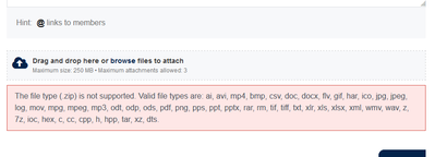

Attached is Gfx project with extension .pdf - rename it to .zip. Forum does not allow me to attach file with .zip. Strange as I see .zip files shared here.
Hi @GaetanGodart
Do you know why my .zip file attachments are refused by forum ? Thanks.

Also, just to add more details to my query:
1. I used textArea1 text field and enabled it as WildCard Buffer is designer.
2. I use 'Unicode::strncpy(textArea1Buffer,textfieldval, TEXTAREA1_SIZE);' in code and this 'textfieldval' will be changed based on microcontroller output.
Please let me know if additional details are required.
Hello @ferro ,
The ".zip" extension is not supported. Most people use the ".7z" extension to share their files.

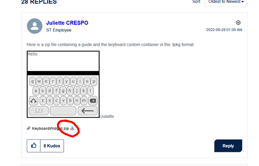

Thanks @GaetanGodart , I see. I saw shared .zip on 'share your widget' thread but that was 2022, it's changed since then.
