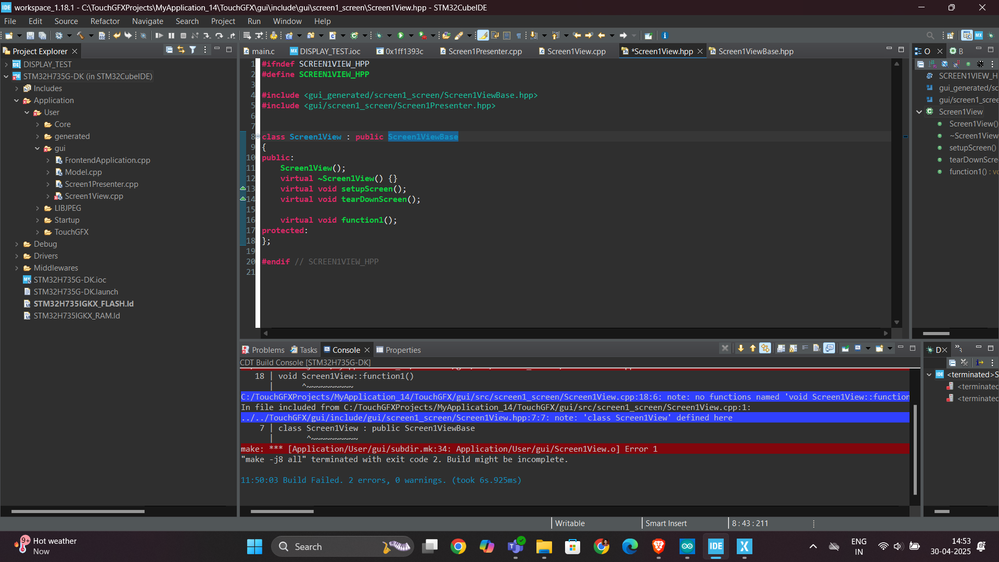

I'm facing a strange issue in my TouchGFX project. I added a new method function1() in my Screen1View class,
and when i create the definition of that function1() in screen1View.cpp it showing the function not declared i followed controllltech youtube tutorial but for me im stuck here.
i will share the .hpp and .cpp and error messages
error im getting
16:39:36 **** Incremental Build of configuration Debug for project STM32H735G-DK ****
make -j8 all
arm-none-eabi-g++ "C:/TouchGFXProjects/MyApplication_14/TouchGFX/gui/src/screen1_screen/Screen1View.cpp" -mcpu=cortex-m7 -std=gnu++14 -g3 -DUSE_HAL_DRIVER -DUSE_BPP=24 -DDEBUG -DSTM32H735xx -DUSE_PWR_DIRECT_SMPS_SUPPLY -c -I../../Core/Inc -I../../TouchGFX/App -I../../TouchGFX/target/generated -I../../TouchGFX/target -I../../Drivers/STM32H7xx_HAL_Driver/Inc -I../../Drivers/STM32H7xx_HAL_Driver/Inc/Legacy -I../../Middlewares/Third_Party/FreeRTOS/Source/include -I../../Middlewares/Third_Party/FreeRTOS/Source/CMSIS_RTOS_V2 -I../../Middlewares/Third_Party/FreeRTOS/Source/portable/GCC/ARM_CM4F -I../../Drivers/CMSIS/Device/ST/STM32H7xx/Include -I../../Drivers/CMSIS/Include -I../../Drivers/BSP/Components/Common -I../../Drivers/BSP/STM32H735G-DK -I../../Middlewares/ST/touchgfx/framework/include -I../../TouchGFX/generated/fonts/include -I../../TouchGFX/generated/gui_generated/include -I../../TouchGFX/generated/images/include -I../../TouchGFX/generated/texts/include -I../../TouchGFX/gui/include -I../../TouchGFX/generated/videos/include -I../../LIBJPEG/App -I../../LIBJPEG/Target -I../../Middlewares/Third_Party/LibJPEG/include -Os -ffunction-sections -fdata-sections -fno-exceptions -fno-rtti -fno-use-cxa-atexit -Wall -femit-class-debug-always -fstack-usage -fcyclomatic-complexity -MMD -MP -MF"Application/User/gui/Screen1View.d" -MT"Application/User/gui/Screen1View.o" --specs=nano.specs -mfpu=fpv5-d16 -mfloat-abi=hard -mthumb -o "Application/User/gui/Screen1View.o"
C:/TouchGFXProjects/MyApplication_14/TouchGFX/gui/src/screen1_screen/Screen1View.cpp:19:6: error: no declaration matches 'void Screen1View::function1()'
19 | void Screen1View::function1()
C:/TouchGFXProjects/MyApplication_14/TouchGFX/gui/src/screen1_screen/Screen1View.cpp:19:6: note: no functions named 'void Screen1View::function1()'
In file included from C:/TouchGFXProjects/MyApplication_14/TouchGFX/gui/src/screen1_screen/Screen1View.cpp:1:
../../TouchGFX/gui/include/gui/screen1_screen/Screen1View.hpp:7:7: note: 'class Screen1View' defined here
7 | class Screen1View : public Screen1ViewBase
make: *** [Application/User/gui/subdir.mk:34: Application/User/gui/Screen1View.o] Error 1
"make -j8 all" terminated with exit code 2. Build might be incomplete.
16:39:37 Build Failed. 2 errors, 0 warnings. (took 860ms)

‎2025-04-30 6:18 AM
There is a * in front of your hpp file name, this is because the file have has a change and you did not save.
Perhaps you added the line 16 and did not save, so for the compiler, the line 16 doesn't exist and same for the zipping program.
Can you save your file and try again?

‎2025-04-30 2:03 AM
Hello @Jerrythottathil ,
When I tried to run your application, it also failed for me.
The reason is that the function declaration un your hpp file is missing (your hpp file is not the same as the code you shared in your first post).
After adding the function declaration to the hpp file (or removing the function definition in the cpp file), it compiled fine.

‎2025-04-30 6:18 AM

‎2025-05-02 9:09 PM
Got it sir!!!
It was not getting saved that was the issue
thank you soo much sir!!
