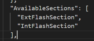

If you open your .touchgfx file with a text editor you will see the available sections :
You can add your own custom ;section here that will contain the single image you want to overwrite, then add that section in the linker script either at the beginning of an existing memory region or in a specific memory region that you must specify first.
