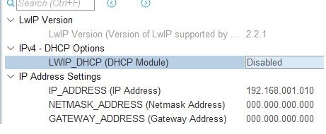

hello
Please find attached the project zip file. I noticed the Net Mask address is all zero's despite setting it to 255.255.255.000 and save project but no matter what it resets to zero's

Hello @ksale.1,
I've analyzed your project, fixed the issues, and attached the corrected version below. Here’s what I found:
1. The names of the memory sections dedicated to the descriptors in the linker file don’t match those declared inside the ethernetif.c file.
In ethernetif.c, the section names are RxDescripSection and TxDescripSection (with an "s"):
ETH_DMADescTypeDef DMARxDscrTab[ETH_RX_DESC_CNT] __attribute__((section(".RxDescripSection"))); /* Ethernet Rx DMA Descriptors */
ETH_DMADescTypeDef DMATxDscrTab[ETH_TX_DESC_CNT] __attribute__((section(".TxDescripSection")));   /* Ethernet Tx DMA Descriptors */
However, in your linker file, the sections are declared as RxDecripSection and TxDecripSection (without the "s"). In the project I attached, these names match the declarations in ethernetif.c. This mismatch was causing the issue, so please ensure the names are consistent.
Here is the relevant linker section:
    .lwip_sec (NOLOAD) :
    . = ABSOLUTE(0x30040000);
    *(.RxDecripSection)
    . = ABSOLUTE(0x30040100);
    *(.TxDecripSection)
    . = ABSOLUTE(0x30040200);
    *(.Rx_PoolSection)
  } >RAM_D2
2. Regarding the netmask issue, in CubeMX configuration, after typing the netmask, make sure to press Enter so the value change takes effect. If it still didn't work, change it manually in lwip.c.
I didn’t need to change anything else. Please let me know if this resolves the problem, as I tested it on my side and it worked.
