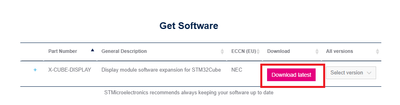

You may find MX25L6433F driver in X-CUBE-DISPLAY package.
Download the package and unzip it. You will find it under Drivers\BSP\Components\mx25l6433f
Or a ready to use external Flashloaders under the path \Utilities\PC_Software\ExternalLoader for the for specific ST boards if you are using one.
Hope that helps.
