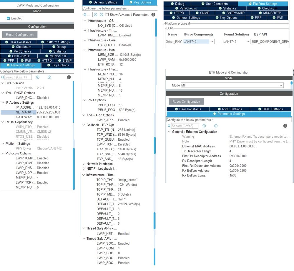

I need to add Ethernet connectivity using LwIP (TCP/UDP echo server). I followed the article “LwIP integration in a TouchGFX project” from the ST community. After integrating LwIP (enabling it in CubeMX, adding the linker sections, creating the LwIP task), the Ethernet part works (ping replies) but the screen stays blank.
I suspect the issue is related to the MPU configuration, especially the region for QSPI memory (0x90000000). Below are the details.
1. Working TouchGFX-only MPU configuration
In the working TouchGFX-only project, the MPU configuration looks like this (relevant parts):
// Region 0: SRAM1 (0x24000000) – cacheable
// Region 1: QSPI (0x90000000) – set to NO_ACCESS??
MPU_InitStruct.Number = MPU_REGION_NUMBER1;
MPU_InitStruct.BaseAddress = 0x90000000;
MPU_InitStruct.Size = MPU_REGION_SIZE_256MB;
MPU_InitStruct.AccessPermission = MPU_REGION_NO_ACCESS;
MPU_InitStruct.IsCacheable = MPU_ACCESS_NOT_CACHEABLE;
MPU_InitStruct.IsBufferable = MPU_ACCESS_NOT_BUFFERABLE;
Strangely, this configuration has QSPI as no access, but the screen still works. This leads me to believe that either the region is overridden later, or the working project actually runs from internal flash and accesses QSPI assets through a different mechanism. I'm confused.
2. After adding LwIP (via CubeMX)
I enabled LwIP in CubeMX, configured the Ethernet descriptors to be placed at 0x30040000 (non‑cacheable SRAM3), and added the necessary linker script section:
.lwip_sec (NOLOAD) :
. = ABSOLUTE(0x30040000);
KEEP(*(.RxDecripSection))
. = ABSOLUTE(0x30040100);
KEEP(*(.TxDecripSection))
. = ABSOLUTE(0x30040200);
KEEP(*(.Rx_PoolSection))
} >RAM_D2

touchGFX working OK. On cmd as administrator --> ping 192.168.1.10 -t gives "Request timeout" . I used MXProgrammer, erased external memory selection starting at 0x9000000, and programmed the hex file in "TouchGFX_LwIP_H750B_Gauge_Webserver-BAK\TouchGFX_LwIP_H750B_Gauge_Webserver\STM32CubeIDE\Debug" . will you verify "192.168.1.10" Best regards
That example requires a DHCP server on your network to acquire an IP address and function properly. Please install software that provides DHCP functionality and try again, or regenerate the project after disabling the DHCP option in the LWIP general settings.
Best regards,
To improve visibility of answered topics, please click 'Accept as Solution' on the reply that resolved your issue or answered your question.
still the
Pinging 192.168.1.10 with 32 bytes of data:
Request timed out.
Request timed out.
Request timed out.
Request timed out.
Request timed out.                                                                                                                                                                Please note the CubeMX config.cubeMX.jpg thank you for your patience
Hello @ksale.1,
After regenerating the project, have you re-added the following linker file configuration?
    *(.RxDecripSection)
    *(.TxDecripSection)
    *(.Rx_PoolSection)
  } >RAM_D2
