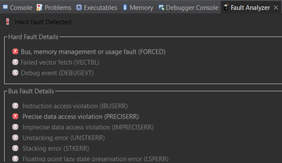

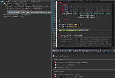

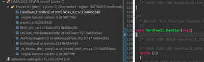

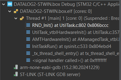

With these changes, I’m able to start logging using a custom device template, and the sensor appears to work initially. However, the system becomes unreliable after a reset.
Main Issue
The board operates correctly until it is reset. After reset, I encounter multiple faults, including:
  • HardFaults
  • Bus faults
  • Memory management faults
  • Usage faults (forced)

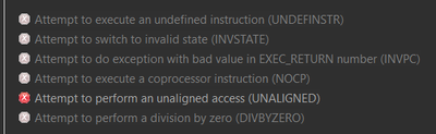

  • Precise data access violations
  • Occasional unaligned access faults
(See attached screenshots for details.)

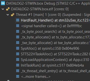

What I Tried
I suspected a memory issue, so I increased the ThreadX byte pool (TX_BYTE_POOL) from 565 KB to 570 KB, but this did not resolve the problem.
Questions
  • Could this be due to incorrect memory configuration or alignment issues?
  • Is there some required initialization or configuration step I might be missing?
  • Is the system tightly configured for the original onboard sensors in a way that affects adding external ones?
