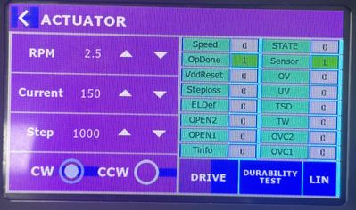

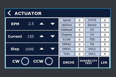

I'm currently using Touchgfx after updating from version 4.25 to 4.26.
When I build and run the code generated by Touchgfx 4.26, Display color doesn't match the design in Touchgfx 4.26.
But When I do the same thing through Touchgfx 4.25, Display color matched very well.

Hey, was this ever solved?
I've run into the same problem and even with GIT Control, and reverting to a previous version I knew definitely worked. Something with the IDE or/and TouchGFX is making the colours change after updating version.
Resorting back to a previous version of TouchGFX 4.25 and colours are still in a different state
