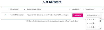

Hello @Marc_LM.
I have verified again, and I can download 4.26.0 from both links if I log in.
The screenshot below is from the second link when logged in.
Best regards,
