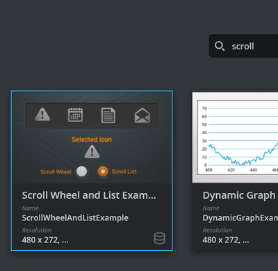

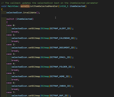

In the scrollList and scrollWheel example, we do update the image when we press one of the scrollList item.
I think this is this part of the code:
Basically, just use the setItemPressedCallback, create a handler for it and then a switch case.
This is also what we do in the tutorial I shared but in the tutorial we use a scrollWheel (this is basically the same).

You should not modify the files ending in "Base" as they are generated and will be re-generated every time so your changes will be overwritten.
Please, follow this tutorial to see how to use the callback.
If you still have questions after following the tutorial, have a look at the elevator demo where we implement a scrollList :
