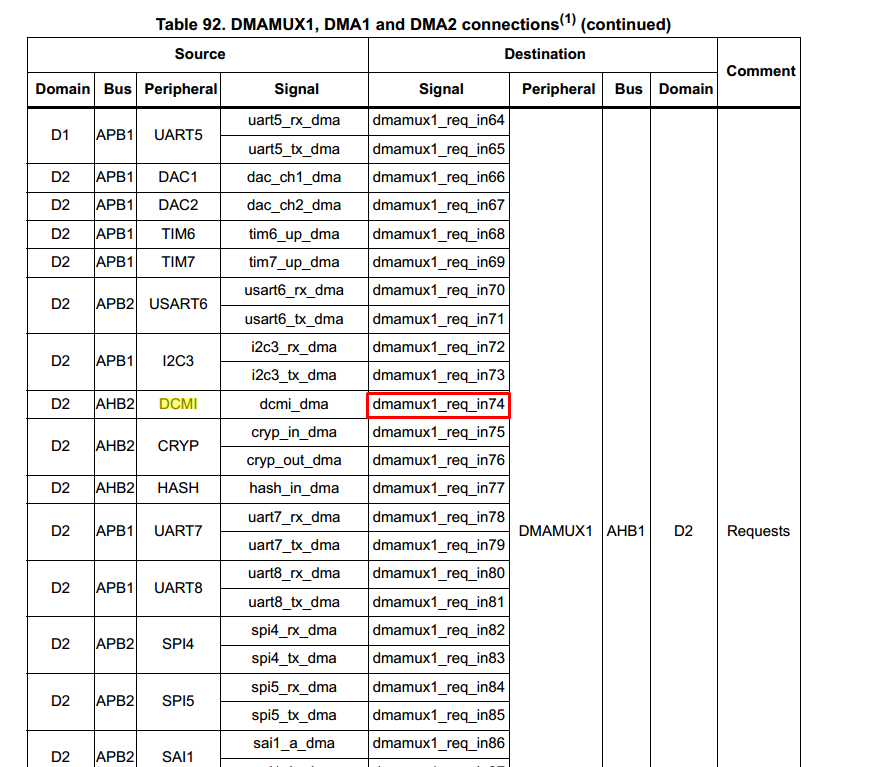

I try to realize DCMI interface with DMA based on STM32H7 kit, and read two manuals such as
AN5020(page 45)
andRM0433(page 638) . I suppose I have found some error. On the screen we can see different DMAMUX1 request. What kind of request should I use?

In prior designs the trigger sources were hard wired, so a particular trigger like DCMI would give you a handful of Channel/Stream selections, and you had to play Will-it-Blend to see if all your resources could work together.
On the H7 the system is more flexible and any of the streams can take any of the sources (channels). Basically you have a knob with 100+ choices rather than 7 or 8 limited choices.
So pick a free DMA stream and route it to the DCMI#75 source

Hello
Sidorov.Pavel
You are right, the reference manual is correct:
DMAMUX1 requestis
I raised this internally to correct the value in theAN5
Thanks and
