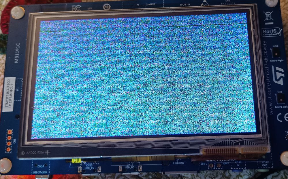

TouchGFX 4.15.0 and ST-LINK 4.6 and CubeProgram 2.6.0 installed to our system Windows 10 64Bit. Board Development STM32F746G Discovery.
I'm tring to run touchgfx samples on the STM32F746G Discovery, every thing goes well and it seems code download completed but display shows nothing but noise.

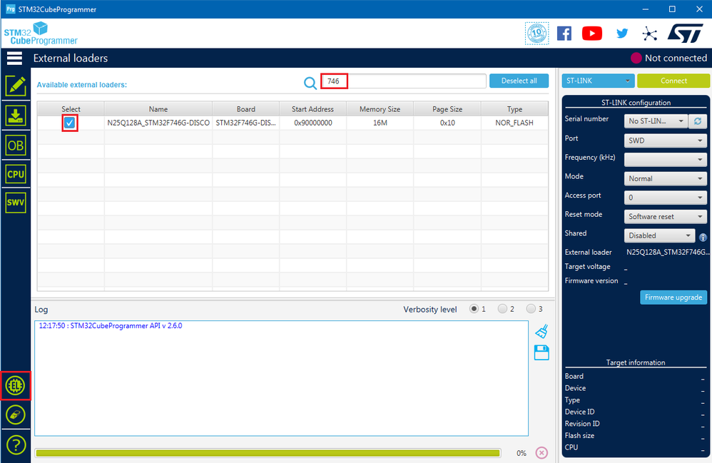

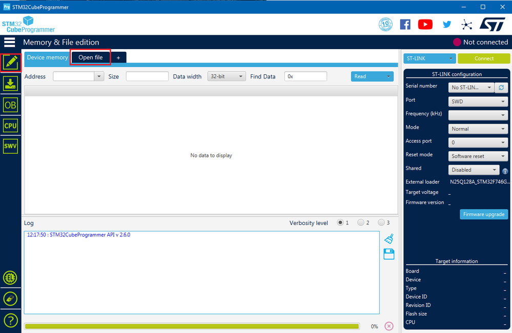

This is due to the external loader file required to program the external FLASH that contains the input bitmaps.
Try this :
  • launch CubeProgrammer
  • click on the "EL" button on the left side panel
  • type "F746" in the search bar and select the only external loader displayed:
  • Then go to the programming panel
  • Open the "target.elf" filethat should be in "<your project>TouchGFX\build\bin\"
  • Click on "Download".
For your information the path to both CubeProgrammer and external loaders are hardcoded for the Designer and I guess something is wrong in your case, you can edit them in the "<your project>/gcc/Makefile" file around line 113-114, seems like $(PROGRAMFILES) variable contains spaces.

This is a CubeProgrammer bug that was reported and is going to be fixed on next CubeProgrammer version 2.7
If using the standalone CubeProgrammer as Nicolas SANTINI explained is not a long-term solution for you, I recommend you to revert to CubeProgrammer 2.5.0 and everything should be fine :)

Hi @N. SANTINI​
I could load my code by using programmer and external loading option.
but the question is when touchGFX generally puts images on the external flash and touchGFX has "Run Target" option which cannot load external flash, why there is a "Run target option ? is it depends on images size or I have to select internal flash for images to can load project from touchGFX directly?
