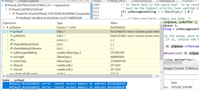

I am using a RIverDI STM32U5A9 and I am facing a strange hardfault issue in my environment.
The connection details as follows:
ESP board <--UART--> STM32 <--MessageQueue---> LCD display
The ESP board sends continuous data through UART and the STM32 UART task receives the data and send the data to LCD display task through message queue. Whenever I try to restart the ESP after firmware update, the STM32 stops getting UART data and reinit the UART once the connection is reestablished. But the application gets into hardfault error when this happens. The hardfault occurs after few packats transfer and not on the first UART reception.

The hardfault is occurring in the subsequent calls of osMessageQueueGet() as I shared in my previous comment.

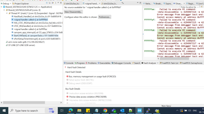

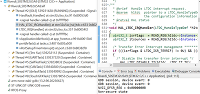

Thanks for looking into my post. To isolate the issue, I removed the message queue implementation and tried the direct copy through extern variable. But the hardfault hits in a different API now. Any ideas?

HI,
I do have the UART Tx in a task and the UART Rx is with interrupt mode. When the UART receives the interrupt, I parse the data and put it in a message queue, eventhough if the UART reinit happens or not, the messagequeue will be holding previous data, but its weird its hardfaulting. I tried to wait in the UART task when there is no Rx data after my ESP reset, but the hardfault hits in a different location like below. FYI, I have removed the reinit logic to test, but the result is still the same.
