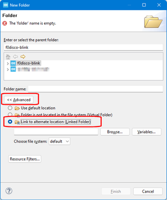

Now, in the CubeIDE's 'Project Explorer', right-click one of your projects, and choose New > Folder
Click on 'Advanced', then check 'Link to alternate location (Linked Folder)':
then you can browse to or type-in the location of your common folder.
Repeat for your other Project(s).

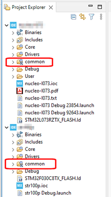

Then the CubeIDE's 'Project Explorer' will show the common folder within both (or all) of your projects:

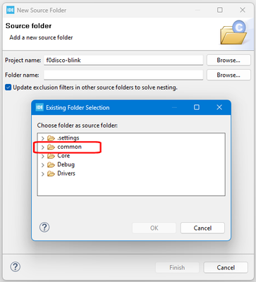

But note that the common folders don't have the 'C' on them - which would mark them as Source folders.
To fix this, in the CubeIDE's 'Project Explorer', right-click one of your projects, and choose New > Source Folder
The common folder will now be available to choose:
So choose it.

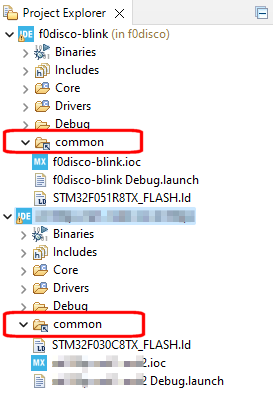

Note that this doesn't duplicate the folder - it just reclassifies it as a Source folder (so adds the 'C' to the folder icon)
Repeat for each Project.
Now you will see that the common folders do have the 'C' added:

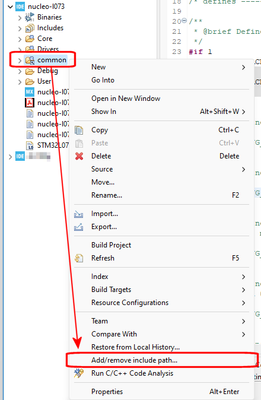

If you have headers in the common folder, you will need to update each Project's Include Paths.
Simplest way is to right-click on the folder, and choose 'Add/remove include path':

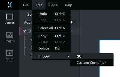

As you mentioned the generated code from TouchGFX requires the corresponding STM32CubeMX project. You've also highlighted an excellent solution for separating the GUI from the hardware implementation, which can be easily done.
You'll need your specific application that you already have for your boards. Additionally, you require a third project based on the TouchGFX simulator to manage your GUI. You can then import this GUI into your specific board application by navigating to Edit -> Import -> GUI from within your hardware project.
Importing a GUI to your project
I hope this helps you, don't hesitate to ask more questions
