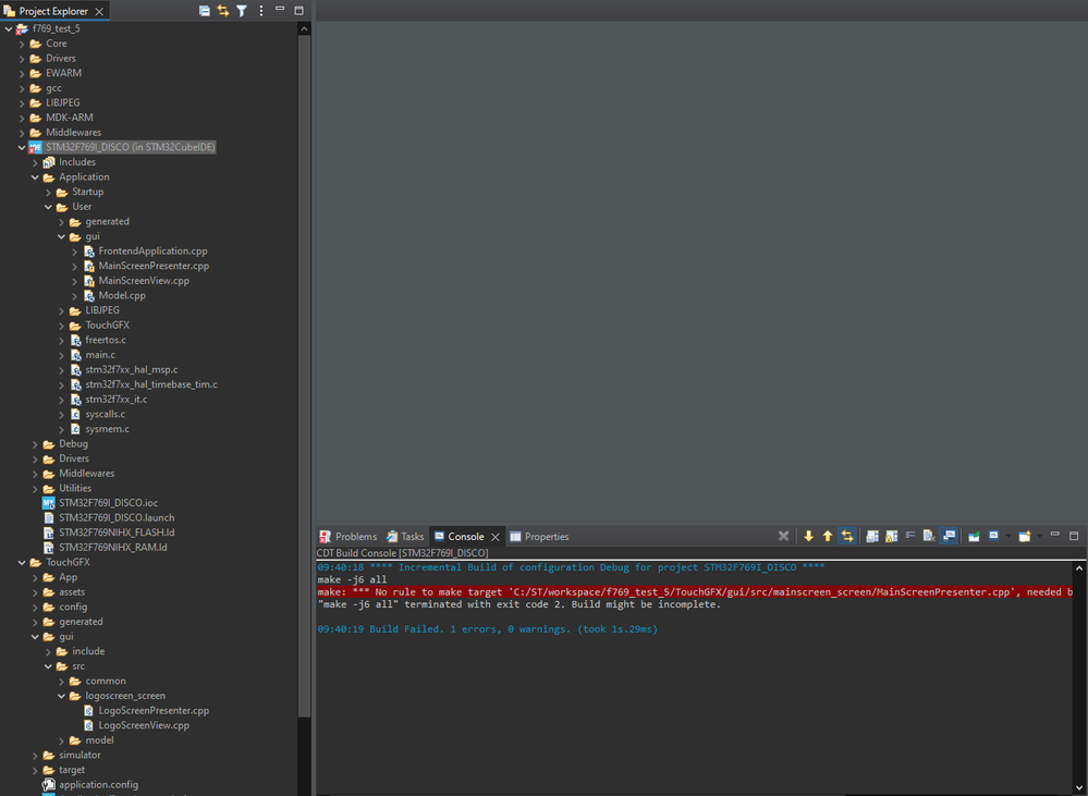

  6. In Designer modify the name of MainScreen to LogoScreen and generate the code

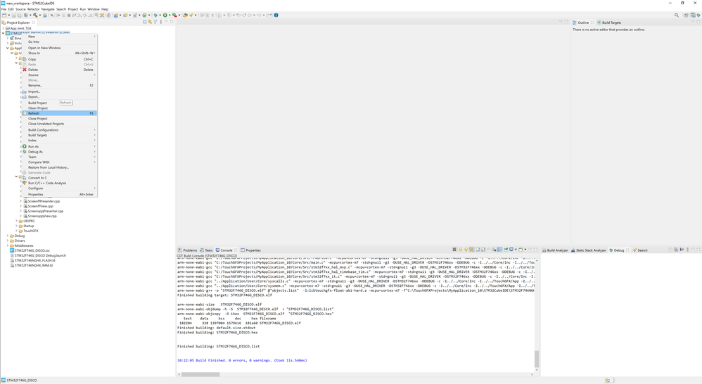

  7. In the IDE refresh the top project before building
  8. Then when I build the files are not updated with the new names and doesn't build anymore,
At this point I have not been able to update the project correctly anymore.
