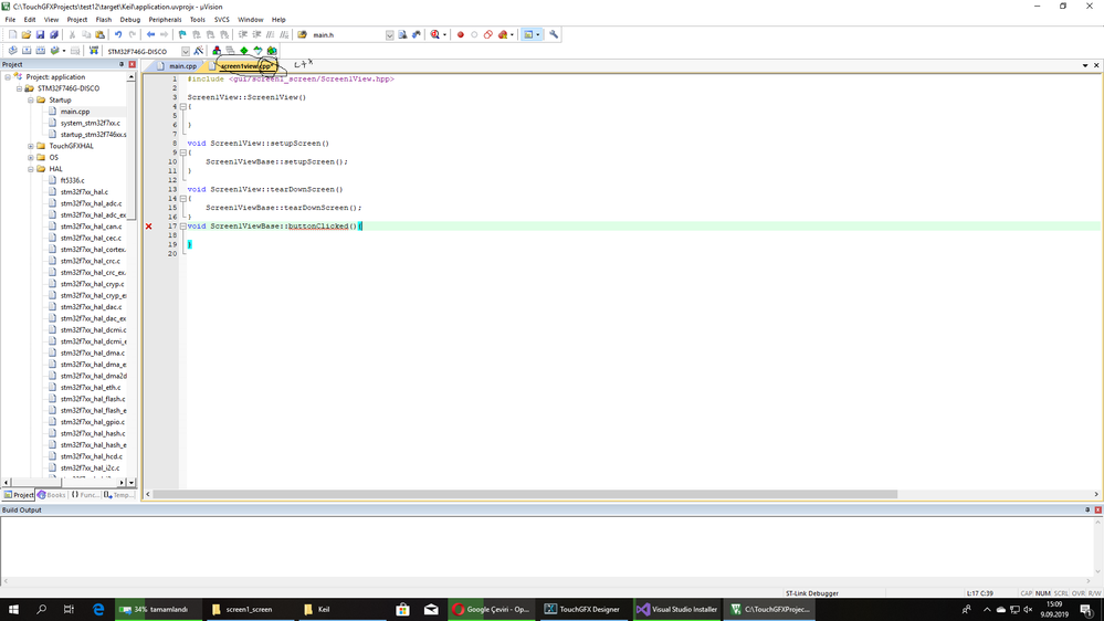

I uploaded the project in this image to stmf746g-disco This project has no interface0690X00000AQt0SQAT.jpg
keil file of the project is here
then I made a simple interface using touchgfx
The problem is how do I integrate the interface code with my real project?
I've seen something like this done by doing some research and watching videos and I've tried
here I created a variable called "buttonclicked"
here already touch gfx has created their own
I'm getting an error here
and most importantly, I do not know how to do this after correcting the error
even if this error is resolved, I don't know how to integrate the next steps
need your help thank you.
in short, how do I integrate my project that I use to draw a wave in my keil project into touch gfx
When I press the RUN button, I want it to bring up the screen in the first image

So what I want to say above is that it has a very simple expression.
When I press the button I want me to open the main project page
this screen but
touch gfx projects are saved as .cpp, but my project is written in .c
I need to write c code to the function I created here but how do I write c code here? because folder is .cpp0690X00000AQv0AQAT.png
the problem is still unsolved can you help
We can contact teamwiever
Sorry, i'm not available for team viewer. You still haven't answered my question:
Are you willing to re-create your simple gui in TouchGFX? You're mixing two different ways of drawing a gui which just complicates things. Your gui seems simple enough to try to re-create.
/Martin
c and c++ can coexist. If you're not willing to create your application in TouchGFX you may be able to program both applications separately onto the board, and when you press a button then have your program counter jump to the old application, and vice versa if you want to go back to TouchGFX.
