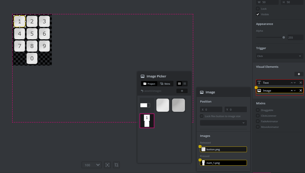

Is it possible to use bigger pressed button image than released button image? How can I achieve it?

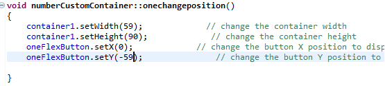

Yes that's normal, so you'll need to play with these functions now :
if (button1.getPressedState() == true) // to know if we pressed the button
container1.setWidth(container1NewWidth); // change the container width
container1.setHeight(container1NewHeight); // change the container height
button1.setX(button1NewXPosition); // change the button X position to display the area you want to show
button1.setY(button1NewYPosition); // change the button Y position to display the area you want to show
container1.invalidate();
button1.invalidate();
/Osman

Hello @Osman SOYKURT . I created virtual function which calls when button is pressed and then changes containers height but nothing happens and I am sure that it fulfils function : container1.setHeight(container1NewHeight); Do you have any suggestions? Thank you.
2022-10-15 8:55 AM
I do like this and changes only button position :

Hello heyo,
Do you use invalidate() function afterwards?
/Osman
