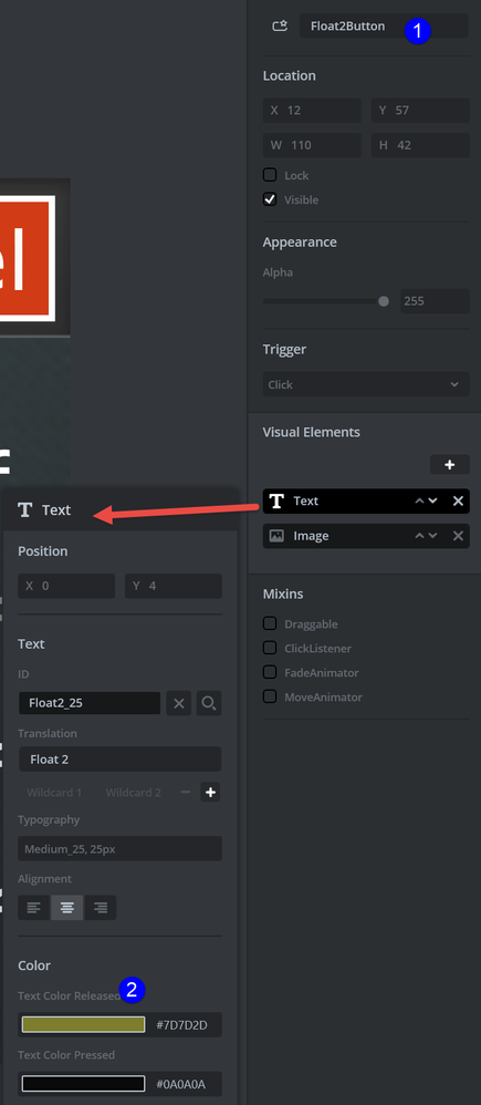

Created this function where want to pass a flex button as a parameter to the function and change it's text color.
Changing the text color directly using the object name works, but when I pass the button to the function I cannot get it work
Any help very much thankful

F3 shows me this
touchgfx::TextButtonStyle< touchgfx::ImageButtonStyle< touchgfx::ClickButtonTrigger > > Float2Button;
