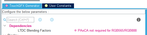

I don't know if this is what is causing my issue on the target, but when going to the TouchGFX Generator I had an issue in the Dependencies area:
I compared the LTDC settings with previous projects (using STM32CubeIDE 1.1.0 and TouchGFX 4.12.3) and they are the same with the Blending Factors being set to "Alpha constant x Pixel Alpha". If I change them to "Alpha constant", the warning in the TouchGFX Generator goes away.
But could this be causing my target to no have anything on the display?
Adding an edit to this post: Apparently this is not an issue, but for information purposes only.

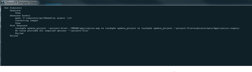

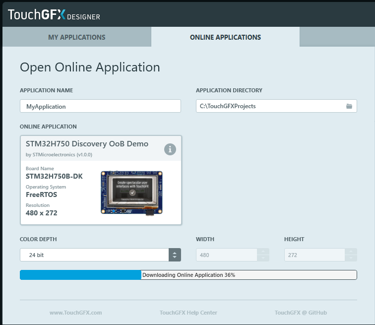

Hi @Martin KJELDSEN​
I successfully downloaded the STM32 Discovery OoB Demo using touchGFX designer 4.13.0, but it cannot be simulated. Why is this?
If you'd read my posts and the documentation therein you'd know that application templates already exist that have these "full projects".
