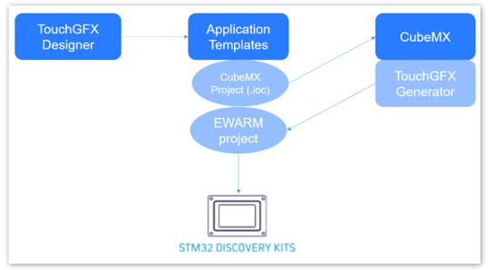

With the release of CubeMX 5.5.0 we've removed TouchGFX from the Middleware section of CubeMX and are now offering TouchGFX configuration through an X-CUBE.
The X-CUBE pack contains the following:
  1. TouchGFX Designer .msi, as per usual
  2. TouchGFX Generator - A tool through "additional software" for creating your TouchGFX HAL based on CubeMX settings.
CubeMX is a tool for configuring your MCU.
CubeMX is not a tool for completely configuring peripherals like touch controllers and external memories.
TouchGFX Generator (new since 4,13) is a CubeMX extension that can generate all or parts of your TouchGFX HAL Layer based partially on settings taken from your MCU configuration in CubeMX.
TouchGFX Generator (new since 4,13) is not a tool that provides complete configurations for touch controllers, external memories, etc. It only generates the TouchGFX HAL - Rendering strategies, acceleration strategies, etc.

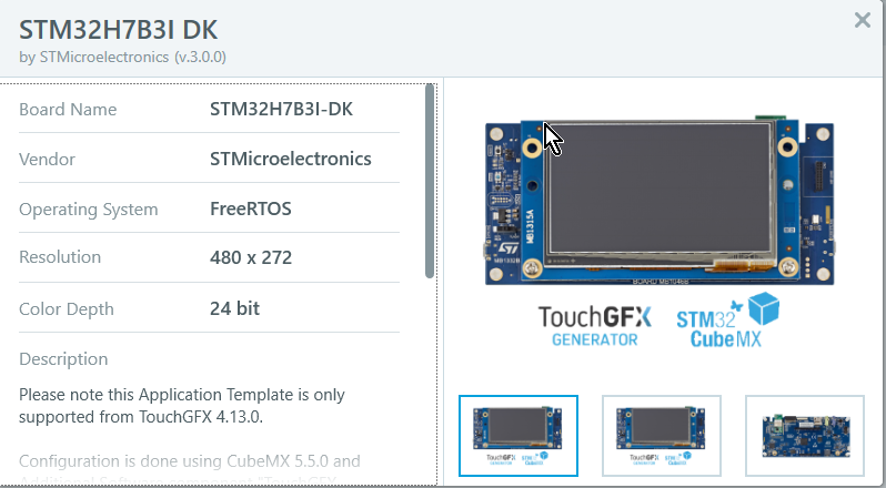

TouchGFX Designer is a tool that can supply you with application templates for existing stm32 display kits. We are working on getting all of them updated to use the new Generator.
Please read the following guides for instructions on how to install the new TouchGFX X-CUBE and how to use the TouchGFX Generator to develop your TouchGFX HAL:
From now on it is the X-CUBE that receives a version bump, bumping the version of both tools contained within.
A few application templates already support the new TouchGFX Generator (and thus CubeMX 5.5.0), with lots more to come. One of our main priorities is to get the rest of the application templates ported to use the TouchGFX Generator,
  • STM32H7BI-DK v.3.0.0 (uploaded)
  • STM32F746-DISCO v.3.0.0 (uploaded)
  • STM32F769I-DISCO v.3.0.0 (uploaded)
  • STM32H750B-DK v3.0.0 (uploaded)
  • STM32F750-DK v3.0.0 (in progress)
  • STM32L4R9-DISCO v3.0.0 (in progress)
  • STM32L4P5-DISCO v3.0.0 (in progress)
  • STM32H743-EVAL v3.0.0 (In progress)
Generally, any application template that supports the Generator/CubeMX 5.5.0 will be major version 3.

CubeMX is an MCU configurator. If you go by the board selector you'll get default IP configurations (But Generator is not connected to the board selector). However, if you now select Parallel RGB from the Generator display interface section you'll inherit the LTDC settings for w/h (480x272 - The default for custom display interface is 32x32.
What we're trying to do is to have APPLICATION TEMPLATES accessible from within the designer that uses the MCU configurator (CUBEMX) + additional code (BSP) to prepare memories and touch controller to run TouchGFX.
The dream is to use CubeMX only in the event that you have a custom board with an MCU you need to configure, or if you have your ST development board that you need to make adjustments to (for prototyping).
/Martin
If you use CubeMX to generate a project from scratch then this IS your application template. You're trying to do something for a custom platform. The designer then allows you to select a UI to put on top of that template - EMPTY or one of the examples.
Start from the designer if you want to have everything configured and just want to create a UI for your stm32 development kit. This once started from CubeMX, from scratch as well, but now we packaged it up for you including the .ioc file that works with the new Generator.
I must have done a right terrible job explaining this in the documentation.
We're working, right now, on updating all ATs to be cubemx 5.5'ified - its a work in progress. So far you can use the H7B3-DK and the F746g-disco, 769-disco is on its way and so is the L4R9-disco, etc etc.
