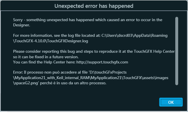

I can't no longer import TouchGFX GUI, every time i try i get :" Import failed, UI is not compatible, but it is, same display size, even same board keep saying that. also ruin my project because when he try to import the GUI, he delete some elements (mostly images).
then if i try again to import same GUI, he gives me Unexpected error has happened 0690X00000AQzgPQAT.png
italian part says :" process can't access to (path) because it's in use by another process... but nothing is using that, i have no other programs running.
i also attached the log file, hope someone can help me figure this out
Thanks

Windows is reporting this. Did you try to either reboot or use third party tools like lockHunter?

yes i tryed rebooting, trying everything, i need a project for H746G_Disco with generates cube, in touchGFX there are 2 projects aviable, 1 with cube (v2.0) and one without (v1.0) if i do the one without cube, import GUI works, but won't work on the v2.0 which is the one i need =(
Zui
Senior
i think i figured out, the problem was (i have no idea why) my antivirus was blocking the imageConverter, now i have other problems, but at least that one is fixed, so if anyone have the same error, try that (although a search option throuh already asked questions would be nice)

I asked because you didn't state that this was a designer error, specifically. I'll pass your difficulties on to the designer team. In the meantime the error means that you're trying to import a gui from a different version (it can not auto-update this imported project).
So, make sure that both projects are the same version, and then redo your import.
