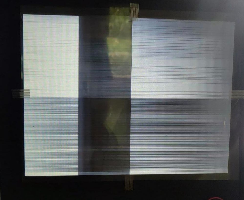

I am working on a custom LCD project using STM32h753 Eval 2. Currently i dont have a tremendous knowledge in LCD. I tried to follow the example codes and some tutorial but not able to make it work. can you suggest any resource or steps to get started?
i am using a custom 1024*768 LCD. This LCD receives signals through LCDT. the config given by the manufacturer is

when i try to modify the example code with these data, i was able to get the LCD ON but did not get the expected result. 0693W000003RQj9QAG.jpg
this is what i get when i change the sync config and clock. what are all the possible reasons where i am messing things up?

Hello @UPa.1​ ,
Have a look on this AN4861 Application note LCD-TFT display controller (LTDC) on STM32 MCUs, this may helps you to configure your project.

Thank you. it seems like the problem was with the custom LCD. its solved now.
