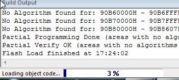

when ExtFlashSection and FontFlashSection are commented (disabled), system loading is OK.
But if these sections are not commented (enabled, written like I quoted) - I get error;
on this stage
I get this error
What's wrong in my SCT file or other settings?
My IC is STM32h743B.
On project for STM32F746B this porblem not occured.

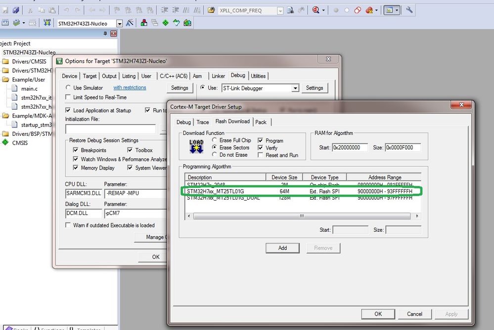

An error you've been told repeatedly is due to you not selecting an algorithm for the QSPI memory on your board..
Only if they want Keil to flash it. I have no issues with mine (it is flashed separately to Keil to speed download speed). I still specify the section and it works fine (just doesn't program it).
"An error you've been told repeatedly is due to you not selecting an algorithm for the QSPI memory on your board.."
I think, that you not read my posts, especially first post.
I select algorithm when I wan to to program flash.
After once programming I delete algorithm from list
Next times I changing onchip flash (without changing qspi flash).
What I have to do if I want to program flash, but no program qspi? Yes, I must delete qspiflash algorithm from list.
