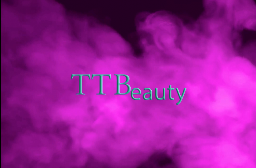

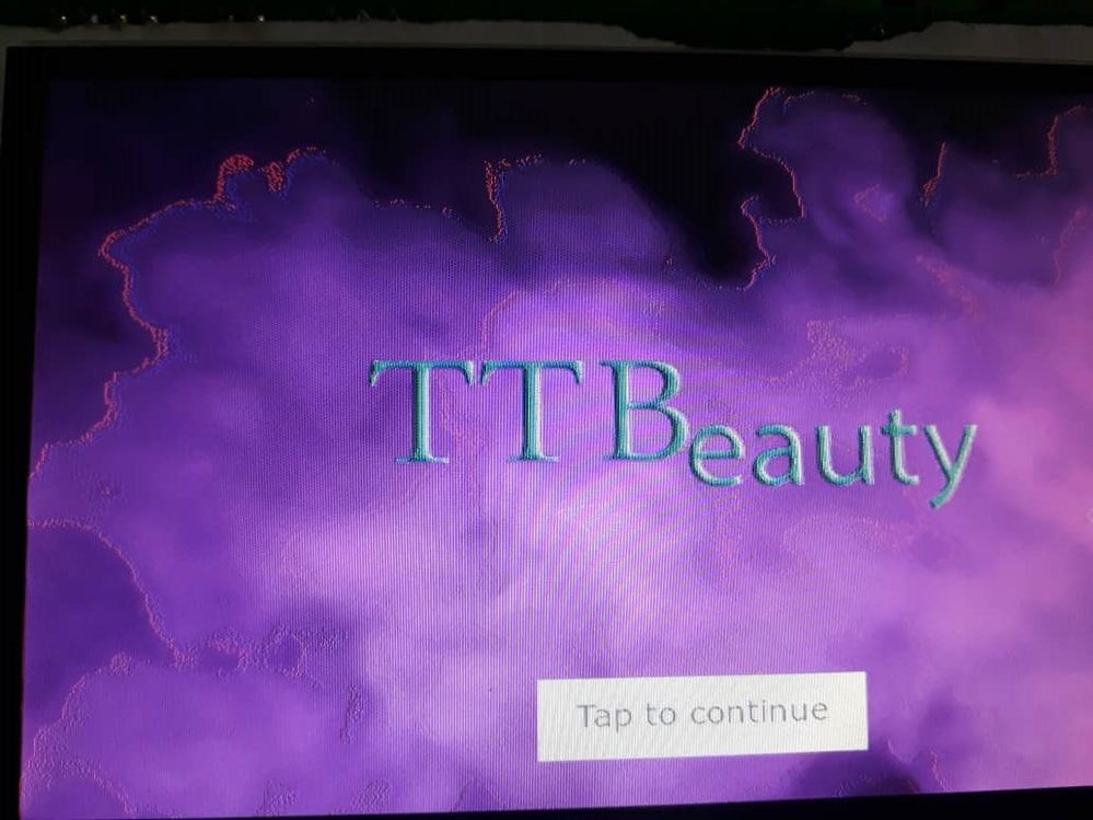

I'm working on custom board based on stm32f429bi that is connected to 800*480 TFT LCD and 32MB of SDRAM. LTDC buffer is configured to be on the SDRAM. I can properly pour whole screen with red, green,blue and any other colors without any problem. But when i try to load a image from sd card or somewhere else, the pixel information of image are corrupted at the "edges" of image. Something like the following two picture:
original image:
and displayed image:
0693W000008G6VOQA0.jpgI'm not sure that the problem is related to LTDC config or SDRAM or something else.
Any help will be highly appreciated.
Thanks in advance
A.Haji

Well you should be able to check the colour depth by plotting a gradient directly into the frame buffer.
Determine if your display has the same colour support as you are driving.
Save the frame buffer for the graphic to a file, and inspect on the PC side.
