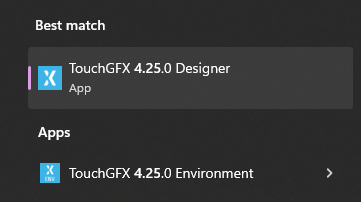

You can search in your windows search bar for "TouchGFX X.XX.X Environment",
Open It should open a terminal, then run your commands inside.

Hello @unsigned_char_array,
Can you try to run the command from the TouchGfx environment ?
Louis BOUDO
Thanks. It works.
open "TouchGFX 4.25.0 Environment"
cd "path_to_project\TouchGFX\assets\texts"
"C:\TouchGFX\4.25.0\touchgfx\framework\tools\textconvert\translations.rb" export texts.xml translations.xlsx
