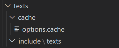

After adding many text fields, resources, and typographies to a screen, I went to compile and was met with errors that generated base classes were using text IDs that did not exist. The text ID's had been added to the source files for the containers they were used in, but not to the header file or TEXTS enum.
In an attempt to "clean" the project I deleted the contents of the TouchGFX/generated folder. The designer regenerates source files, but generated/texts/include/texts is empty. I have tried to add/remove resources in the designer so it would detect changes in the spreadsheet without any luck. With an empty folder my compile errors are now:
../TouchGFX/target/generated/TouchGFXConfiguration.cpp:17:10: fatal error: texts/TypedTextDatabase.hpp: No such file or directory
 #include <texts/TypedTextDatabase.hpp>
How can I force the designer to regenerate these files?

This still leaves me with generated/texts folder that only contains options.cache and an empty include/texts folder.

​Odd, i just created a blank project, generated from the designer and have two files "TextKeysAndLanguages.hpp" and "TypedTextDatabase.hpp". Can you try from the designer? If that works, then maybe it's an issue with tgfx.exe.

Here's why: I had an "unexpected character" in a wildcard range. TouchGFX allows you enter a character it cannot process. And it's practically any character that is not alphanumeric. For those use hex codes, so to select range of all printable ASCII use 0x20-0x7e.
Anyways, I changed the offending wildcard range and it started to generate texts correctly. It's clearly TouchGFX bug and a big one.

The same thing was happening to me. I could not generate new texts after adding them to an old project, or even change the justification/font size of text IDs that were already generated. After I updated to 4.24, I can now delete the generated folder and it will generate the new texts I have added. It will not generate them if I add any more after I have generated the files once, i have to delete the whole folder again. Make sure you delete the generated folder, and not just its contents.
HTD is right, it is to do with the ranges used in wildcard buffers. I get the below error when I generate for the first time.
WARNING - Char 0xC0 is used but does not exist in the font!
WARNING - A total of 64 Unicode characters did not exist in the font!
It would be nice if the code generator could ignore this error instead of failing to generate new files.
