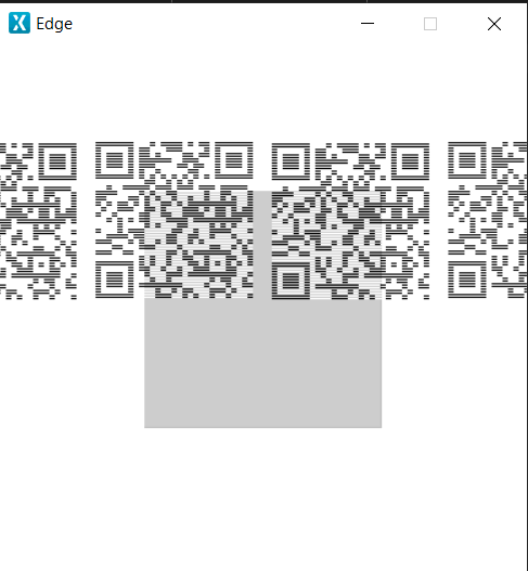

‎2021-09-01 9:53 PM
Hello @Alexandre RENOUX​ ,
When I try to implement QR code for 16bit resolution, it's working fine. But, when I try to implement the same with 24bit Resolution, QR code is appearing as glitch. Can you please help me fix the issue. I am attaching the snip of simulation.
‎2021-09-06 12:45 AM
Hello Revanth,
Indeed when switching to 24bpp the QR code is not working. It's because in the draw() function, we consider a 16bpp 2framebuffer to set black or white for each pixel. In case of 24bpp, the draw function needs to be modified to match this color format.
You will find attached the 24bpp version of the QR Code example (TouchGFX 4.17).
/Alexandre
