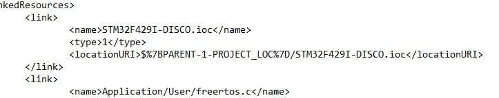

I was trying to connect project from touchgxf with stm32cubeide with opening .ioc file in cubeide folder. Everything was imported succesfully , except .ioc file .Maybe i did it wrong , but i'm not sure.

Hello @R4tlehed​ ,
Inside the STM32CubeIDE folder, in your project directory, there is a .project file.
If you open this file in a text editor, you can see that there is a reference to your .ioc file, e.g :
Did you check that this path points to the right file ?

‎2022-06-20 6:02 AM
Hello , Yoann KLEIN (ST Employee) ,
There is a problem , i checked that file and i don't have any path to .ioc file , can i add by myself ?

‎2022-06-25 1:29 PM
Hello , Yoann KLEIN (ST Employee) , i've tried to add a link to .ioc file in .project , and its added a .ioc file in cubeide , but i can not open this file , also it is not visible in folder from a windows perspective . There is a photos what's happening while trying to open .ioc file and a .project file with added part of a code which is adding a link to .ioc
