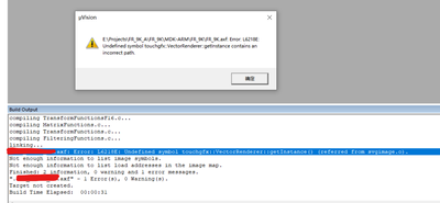

However, after I finished the design in TouchGFX Designer and tried to compiler the project by MDK-ARM, the following error was present:
(When I delete the SVG object in TouchGFX Designer, everything works well again.)
I don't know what this means, how do I resolve it?

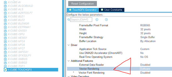

My question can be resolved by enabling "Vector Rendering" in cubeMx.
