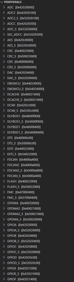

Hello Team,
Since SCB and other core registers are not included in the SVD file for STM32H5, could you please advise on the best way to access or monitor SCB registers (e.g., VTOR, AIRCR, ICSR) during debugging in VS Code with PlatformIO?

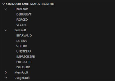

Nawres GHARBI
you can use the fault status register view in the debug pane of VSCode
i dont see the fault registers
Nawres GHARBI
which version of the extension are you running ?
These are the svd files we are using.
STM32H533.svd
I have the attached the same.

Nawres GHARBI
so I invite you to use our extension where you will find more features
