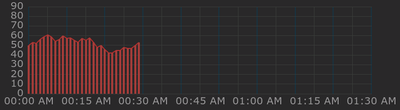

Note that if you do like this, one point must represent value of one minute in your data to get time domain correct !
Then, your data will naturally start from time 00:00

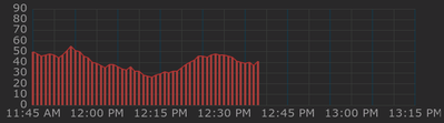

 Then you can set in your view.cpp something like
dynamicGraph1MajorXAxisLabel.setXStartOffset((11*60)+45); //11:45 AM
And then time starts from 11:45 AM

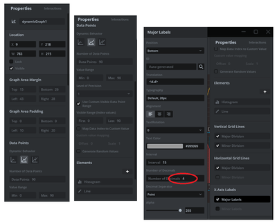

Here are the most important settings of graph in this example:
Number of decimals is set to 4 to activate extended time formatting for X labels. Since the Y label uses the same formatLabel function, there is must something that activates Time format for x labels but not for y (in most cases not needed to have time also in Y label).
