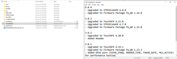

If you started your project from a TouchGFX Designer you should have in your project folder a file called changelog.txt. In this file, we mention all the versions of the tpa (at the release date) and changes between them. Something like this :
In this example, I know that the version of the tpa that I used was version 3.0.4. (The latest as of today is 3.0.7 for this TBS).
If you update your TBS to a newer version of TouchGFX, this file will not update, so you always know the version of the tpa you used when you started your project.

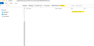

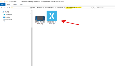

What you can do then is to navigate to your AppData folder (C:\Users\YOUR_USERNAME\AppData\Roaming\TouchGFX-4.21.0) and see which version of the TBS was downloaded by TouchGFX. If you have worked with different TBS versions, it will not tell you which one you have used, but if you have used only one, you will see only one tpa among the different folder (versions) of this TBS.
In this example, for the same TBS, there's only one tpa downloaded and it's version 3.0.17.
I've checked in my 4.21.0 folder and I don't see an EDT TBS. Make sure it's with TouchGFX Designer 4.21.0 that you created your project from.
