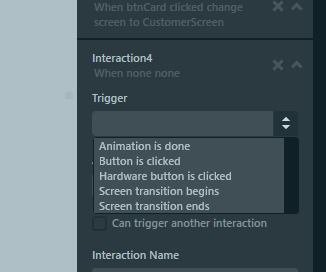

Thank of your answer!
I tested the "change screen" with "Animation is done" and "Button is clicked" in the trigger of the interaction.
However, i want to do the change screen when i click on the animation while the animation is running.
